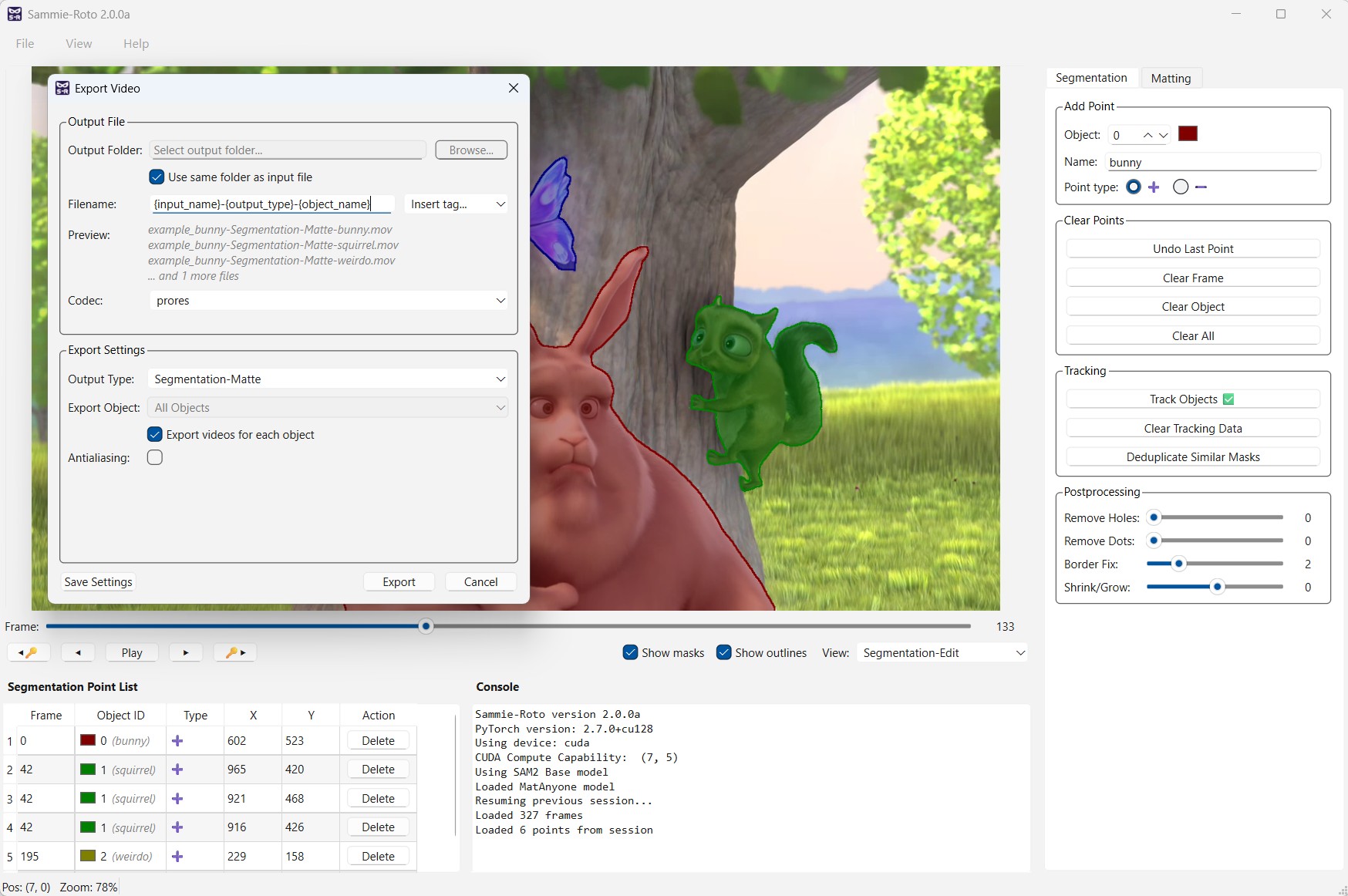

I was surprised to find such an active discussion about my tool, Sammie-Roto!
Here is a teaser for the upcoming version 2! (Hopefully within the next couple months)
