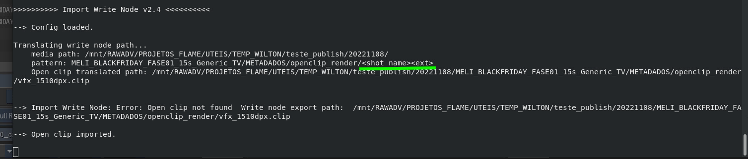

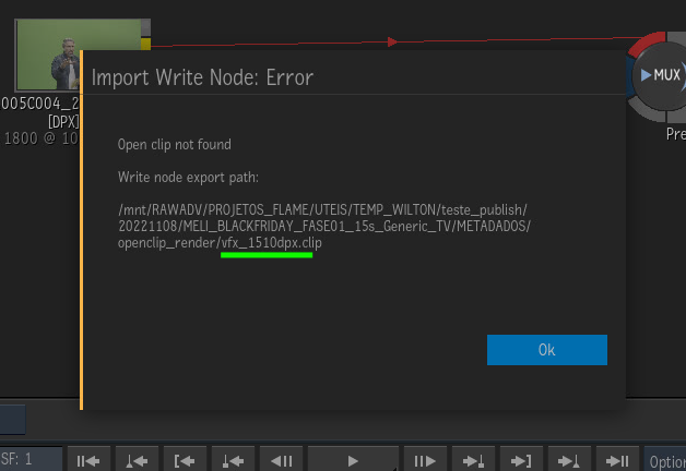

I’ve tried to import Openclip on Write Node but is showing some error when trying to find path, maybe because on absolute path is considering the extension “dpx” in file name but the openclip on folder file doesn’t have this information. Could you have any idea what’s happening?
Wilton
error_import_openclipe
Remove the ext in the file path on the writenode. Meant to write @MikeV about this… the writenode will still write correctly and read as well. it strikes me as a bug.

Exactly @MikeV this problem happens only when considering the token with the extension on the final path.

I put a new version of the script up on the Portal which shouldn’t have this problem anymore. If you get a chance to try it out let me know if it works for you guys. Thanks for letting me know about it.
Mike
Now it works perfectly, thanks :tada: :tada:
