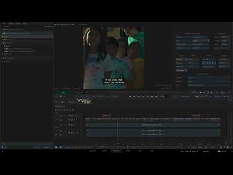

We had some technical difficulties last night and only @andymilkis , @bryanb and I could see the contextual windows and my scripts, so I thought I post it here.
The video is 12 min, but here are the highlights.

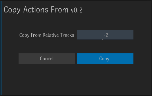

Copy To and Copy From:
copy_from
copy_from

I shared this video on another post, but wanted to share it here too because it’s related to the last year’s presentation. It’s a much faster version of the Copy Action To/From shown above. As a little bonus, it seems to fix corrupt Actions often seen when importing XML’s.
