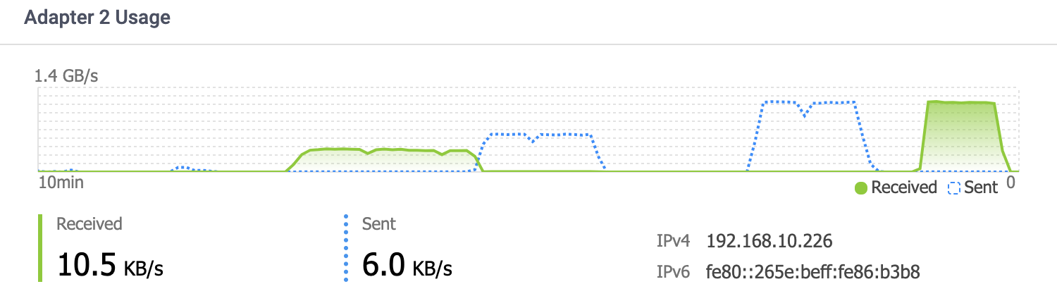

did a test with uncompressed UHD frames via 10Gbit NIC
NFS
W: 400MB/s
R: 650MB/s
SMB
W: 1.2GB/s
R: 1.2GB/s
SMB seems to be FAR faster and gives me constant line speed in real-world read and writes from inside of flame. at least on my mac studio clients.
Left test is NFS , right one is SMB …
