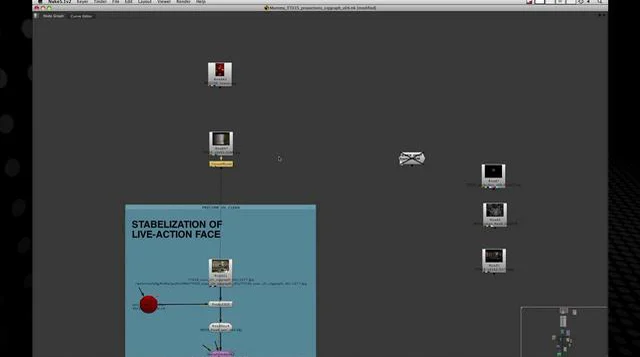

Camera tracking and UV unwrap techniques

Quick question, I’m getting jaggy black edges at the end of the image projection and back plate, as well as where the projection crosses edge of frame, any easy way to get rid of that?

Mocha unwrap shot?

Maybe try outputting an alpha and unMultiply.
That worked. Changed the premult in action fixed on the BG and FG edge and switching the stabilized projector to mirror repeat fixed the edge on the edge of frame.

I tested it using UV Warp at the end to comp the clean up which worked pretty well too.
One question if I may. Open to all. I tested old fashioned projectors and compared the results with a diffuse layer projector. I discovered the diffuse layer projector was much softer than old fashioned projector. But only on comping on the still at the end. Why?
Double filtering in the map and the surface maybe versus single filter hit in projectors?
