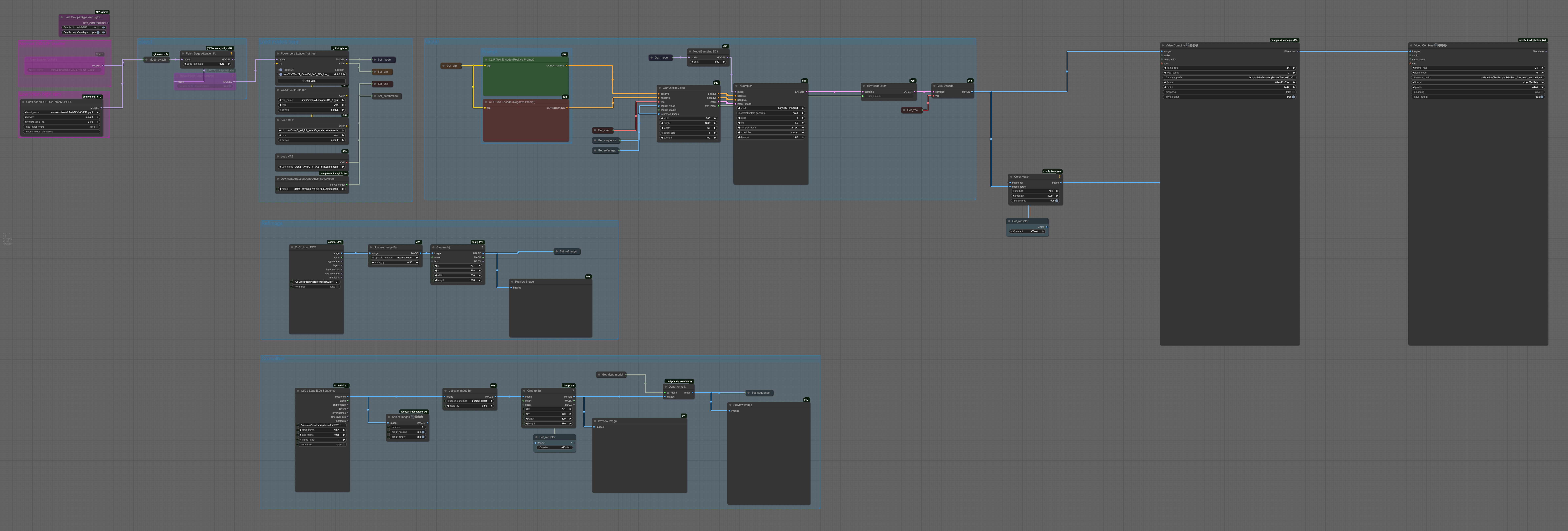

So here’s one I started adapting tonight, also seems to just work and should do very much what you’re after. I started throwing in Coco Sequence loaders and inline crops to increase pixel denity but figured I’d pass this earlier (working) version along before I break too much.
Start by bypassing the samplers, set the desired width (ie 1024 for us mortals) and the height is computed based on the AR of the incoming image, set the points for masking the object you want to replace and then use the pose selection to go for DWPose or DepthAnything. I prefer DA–but whatever. Load your reference for the switch and you should be good to go.
Unlike the other one, this one just goes full out on a reference image that can have nothing to do with the first frame of your sequence whatsoever.
My main issue at this point is resolution with my GPU, which shouldn’t be an issue for you @randy
Also, for anyone who wants to try these, the comfy setup is embedded in the screen cap. If you drop the png in Comfy it will load the workflow automatically. At least it should–the zips are definitely clean and tested.
