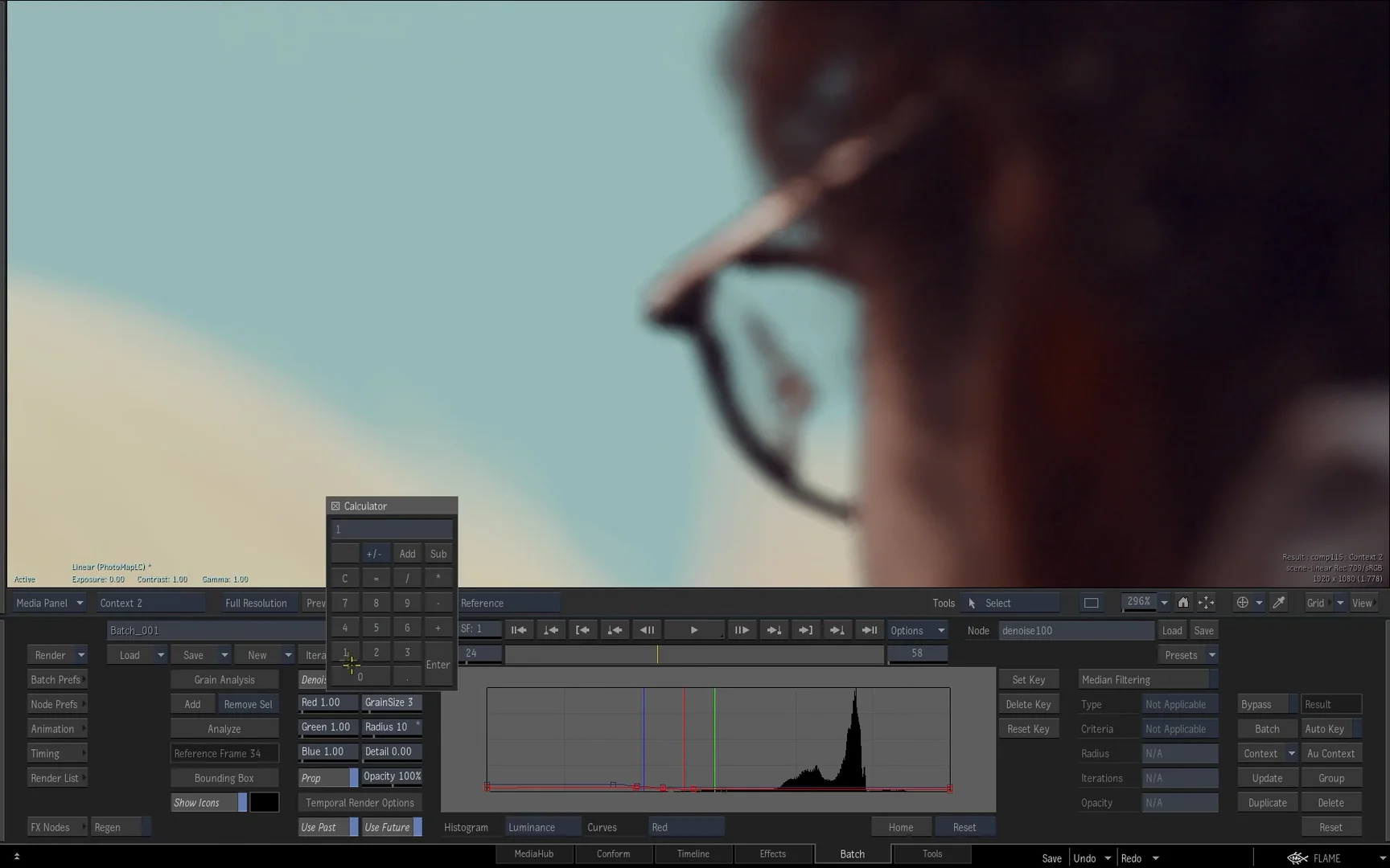

(a still from our latest road safety ad)

What do you think of the visual quality?
Donwloader Expired
Is this for real, or exaggerated? The wide open pupil looks quite abnormal.
Sorry, I meant the size of her pupil. The quality looks clean/great.
