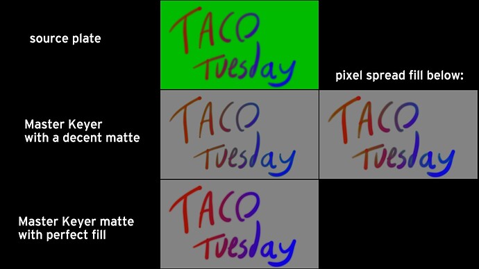

Hahaha. Yeah, but I stand by it. I’m salty because none of the keyers have good fill-creation tools.
The hardest part of a key is making a good fill. The matte is comparatively easy. Without a good fill you’ve got terrible edges. The software doesn’t offer great solutions (cross your fingers and pixel spread, or paint every frame’s edges). Even preset keyers like the Modular Keyer just say, “well have you tried suppression and eroding the matte?” with the tools they load up.
I’ve attached a very sloppy example, but what I did was make an element on green and then key it. If I can create a perfect fill akin to a CG render that’s been divided, then my work is basically done, but if I cannot create that I’ve got hours/days of nebulous work ahead of me.
And that’s why I say that the keyers give shitty results: they don’t help you deal with the fill and thus your keys will look bad.
