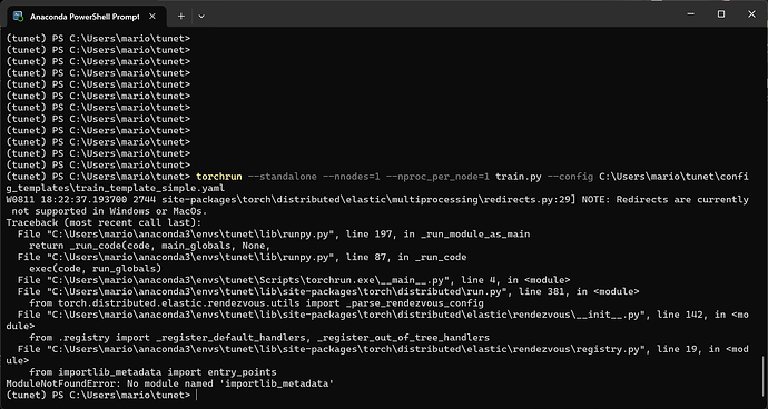

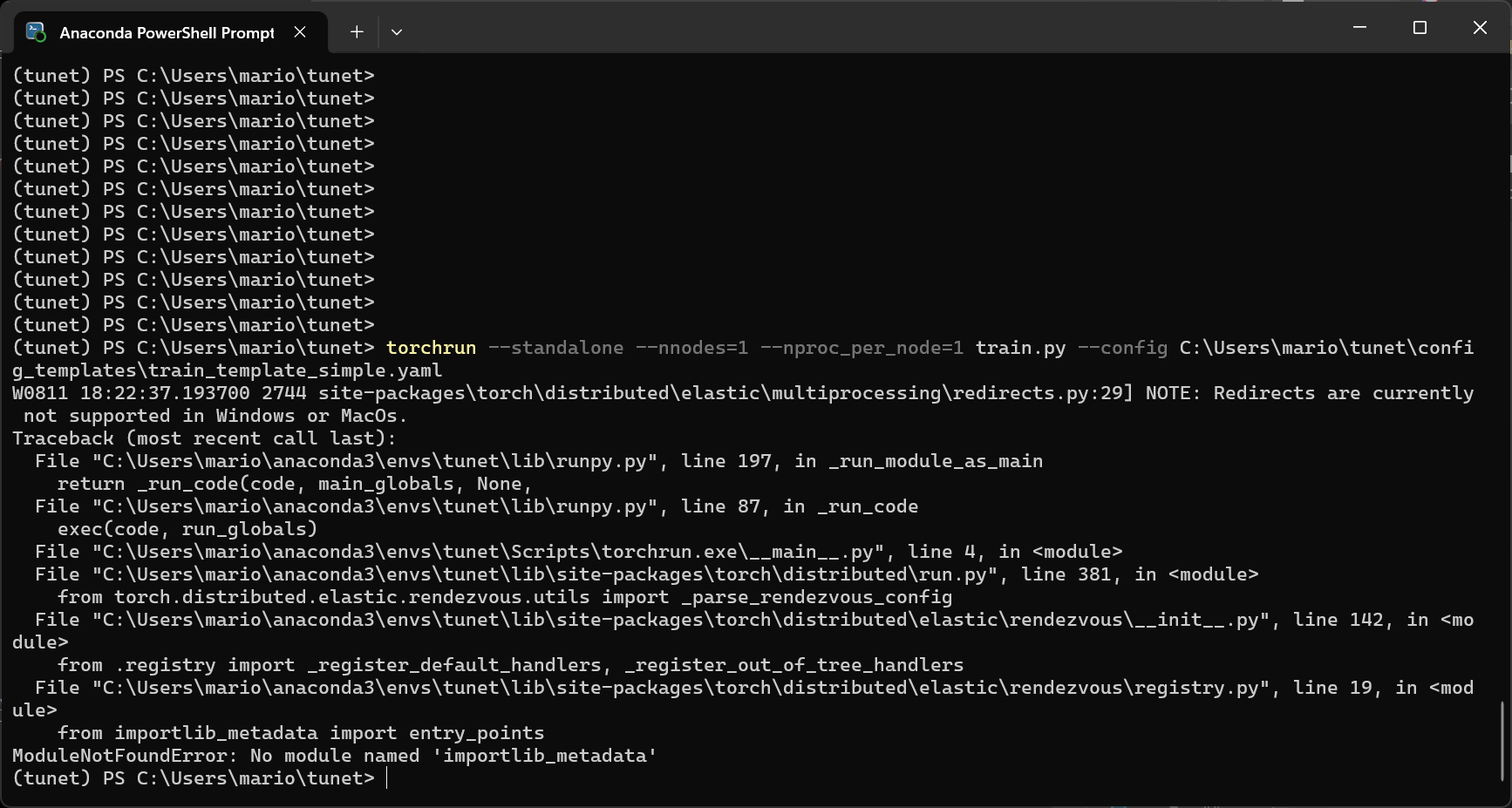

Thanks this looks great, … thought i try it out on windows, and got stuck here trying to start the training.
any ideas ?
Many Thanks
