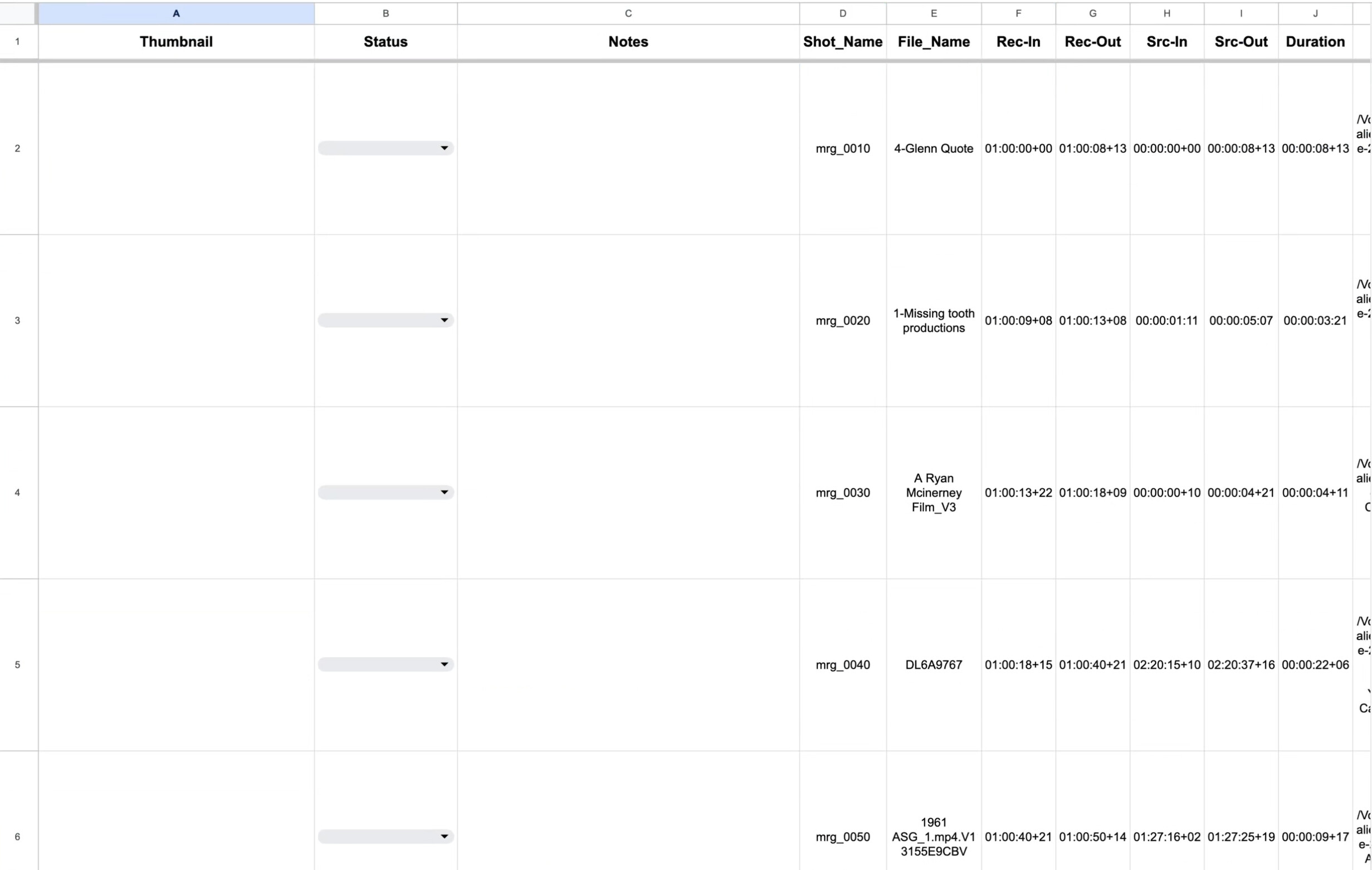

  1. Prep your timeline and export your .csv from Flame. The simpler your timeline (track-wise) the better, since you’ll want to ensure it’s just a big list of shots sorted by shot name. I duplicated it and removed any graphics / audio / references just so it was as clean as possible requiring little cleanup afterwards. I found BFX with clips inside them can add some confusion since they might not have shotnames, but will still show up in the Conform list, so be warned you might need some more cleanup.

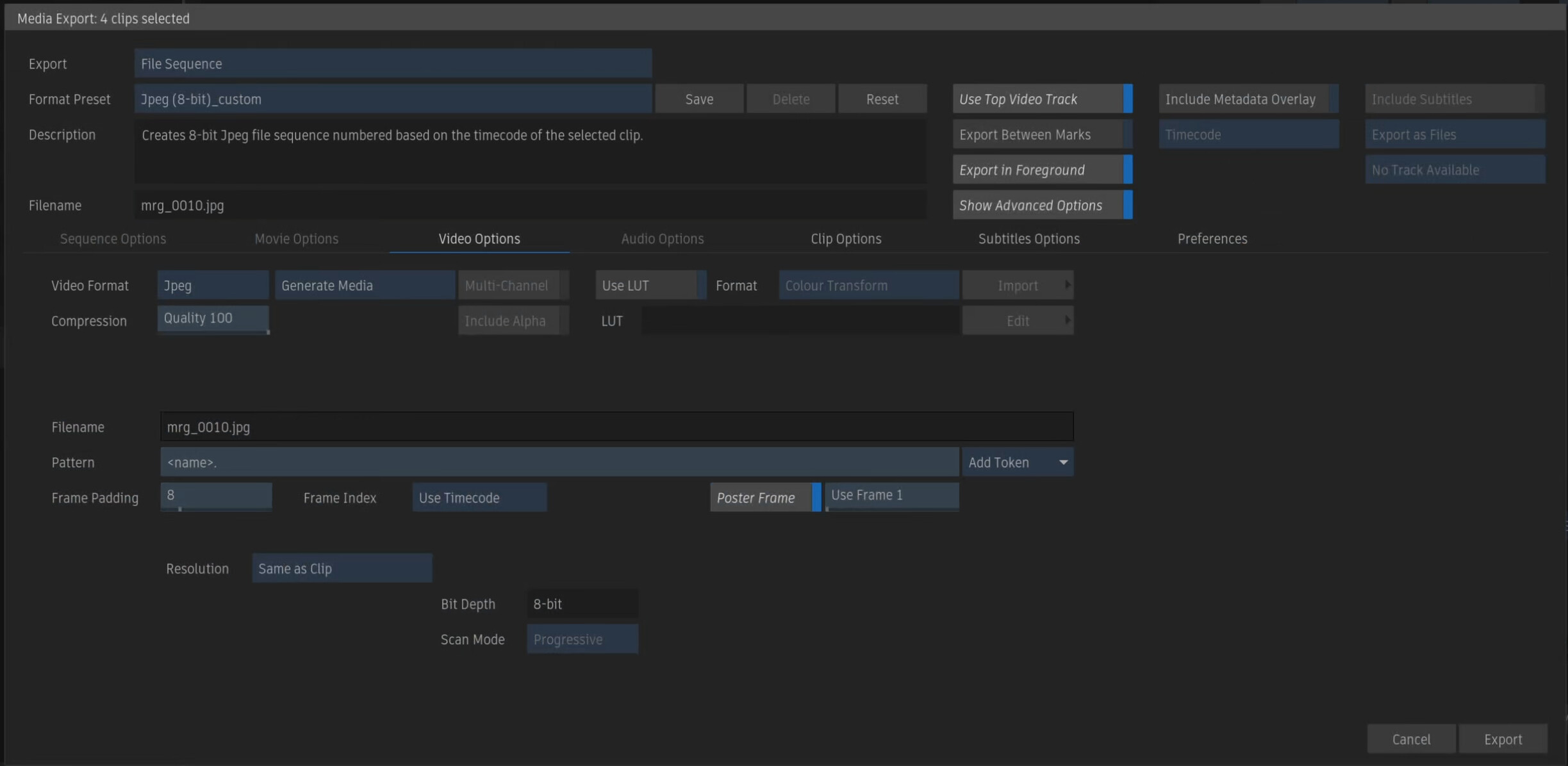

  1. Export a .jpg still of every shot named by shot name. I know in some workflows you might want to get more granular if a shot has multiple clips, and so a single shot name wouldn’t cut it, but I wanted to keep it simple for a proof of concept but I think the important thing is that you have a column of names that match the name you export, so keep that in mind. I chose to go down the route of matching out every segment into a reel, exporting a File Sequence of Jpegs set to Poster Frame mode using Frame 1, and ensuring they are all named based on the shot name. I found I needed to change all of my segment names to shot names just to simplify the export.

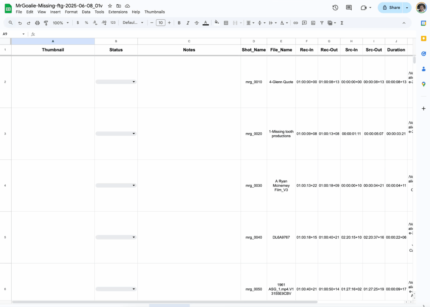

  1. Upload your exported .jpg’s to Google Drive, Import the .csv into Google Sheets, and clean up the spreadsheet based on your needs and personal preference of layout. But regardless of what you change, definitely add a Thumbnail column, since that’s the point. Ensure you set the Google Drive folder to have wide open permissions “Anyone with the link” set to “Viewer”.

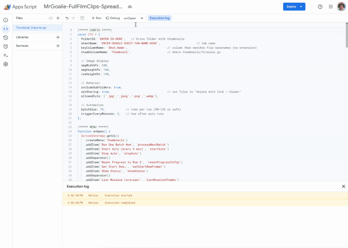

  1. In the Google Sheet, go to Extensions → Apps Script and paste this script in the Editor area:

  1. Once the script is pasted in, and you’ve adjusted the config for your folder ID & column names, hit the “Save” icon to Save project to Drive. Then, note this dropdown at the top of the Apps Script. You twirl open this dropdown to choose which part of the script to execute.
03-apps-script-part00
Run the “onOpen” part to initiate the permissions integration. You only need to do this once.
03-apps-script-part01-rev
Once you run that and give it permission to your Google Drive, run the “startAuto” script and it should start.

  1. In your Google Sheet, your thumbnails should start populating. Unfortunately, there’s very little feedback or progress bars, but in my experience I let it run and it got through my 900 thumbnails in something like an hour.
