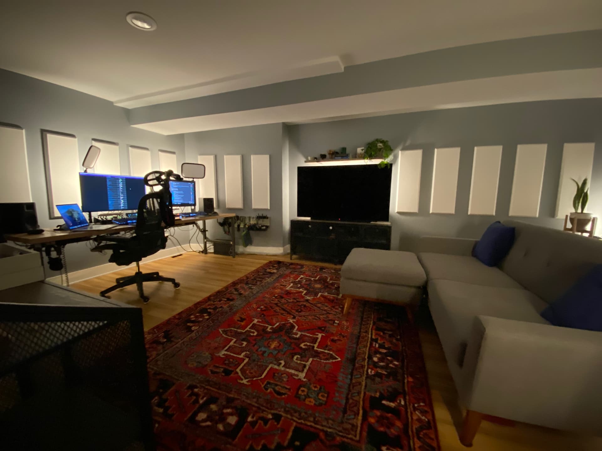

FWIW, I find a 3-screen setup to work great for solo sessions and with clients. Flame UI on left, my close result monitor in the middle, and big screen result on the right. I like being able to look over at “big pixels” on the right when I want, and it’s good for clients as they don’t have to look through my fat head from behind. Some clients also like pulling up an Aeron next to me so we can look closely and they can smudge the screen with grease from lunch.
Lookin’ good GP!! :slight_smile:
@GPM amazing setup. Love the architecture of the house too.
