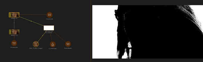

The setup - delete the default master grade in your selective (helps keep the priority order correct, or you’ll have to use the priority editor later to fix it).
Then add this custom version of crok_jt_key, for simplicity also add id_ShowAlpha, and then a Mastergrade.
crok_jt_key looks like it was originally conceived as a chroma keyer. The original version also has despill and some other features which are disabled in this custom version for now.

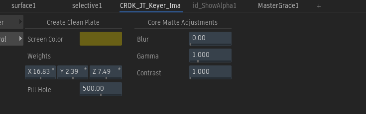

Sample the color (be sure to not use color management), look at the alpha channel, and adjust the x y z values to taste. Also the matte refinement.
It will look like this, because of id_ShowAlpha. When happy, just hide id_ShowAlpha so that the matte gets passed on to Mastergrade.
