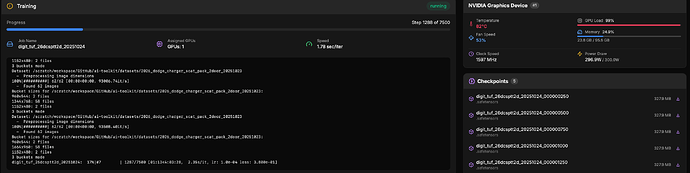

attached is mine.

now I just need to modify all my old yamls to fill up all the VRAM. And yah, working through the fan % boost and maybe power boost you reccomended earlier @tpo
