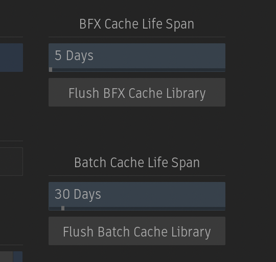

Hi guys, I’ve got a problem when I render in Big Batch: the render always freezes. It’s not freezing on a particular frame; it’s random. One minute it’ll freeze at 100 frames, then it’ll freeze at 170 frames. It’s only 200 frames; it’s not a very big comp but it just randomly freezes and doesn’t continue. I have to force quit Flame and come back in. However I did discover that flushing the cache under preferences fixed the issue. Which leads me to my question: what is this cache holding for 30 days that is set in preferences?
