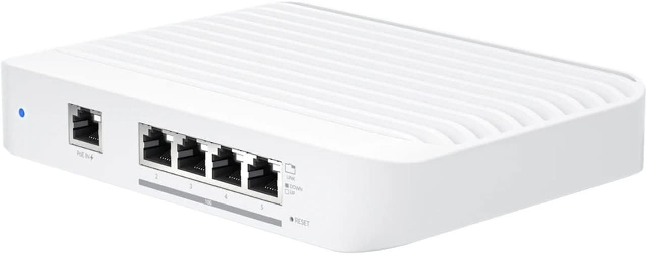

All my devices are in fact RJ-45. I have a MacStudio, Synology, a MacMini and a MacBookPro (2.5Ge Dongle) and I think I’m probably going to go with the Unifi because it’s got some managed features and I can limit the traffic for the home office stuff within that device. I’m not sure yet if it can make VLANs to really wall off that traffic, but I have had one of their Wifi repeaters for many years and it’s excellent.
I really appreciate everyone’s comments on the SFPs running hot, and I did confirm with several sysadmin friends that’s the case. I can only imagine your Mikro melting…yikes! Its good to see you recommended the Netgear - it was also an option as were a few others including the QNAP, TP-Link and TRENDNet, but for nearly the same price having a few extra management features seemed like a good bet.

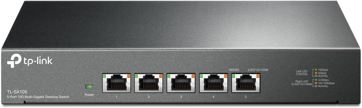

This one’s fine
Hi Sam!
Thanks for the link! I went with this:
It’s been amazing. Minimal configuration and no hassle since I bought it. I’m a pretty big fan of their gear now because the setting up was very smooth…
Probably the same chips inside. Mine’s been awesome for my 10G computers. My OS update for my Mac downloaded at over 400MB/s the other night over 7Gig Fios. Infer what you like about how exciting my life is these days…
