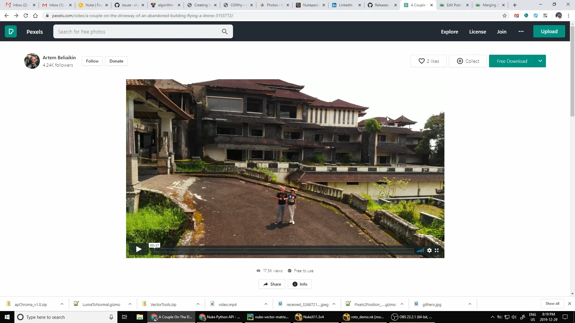

While perusing the net I found this little gem of a toolset for Nuke, which, amongst a lot of super useful concatenation hacks and other transformation converters, would allow a card to be converted to a cornerpin which you could then invert. So smooth….
Lovely what having access to the matrix data for transforms allows you to do.
Matrix utility is awesome in Nuke, you can do a lot with these, but remember you got the UV output in the ScanlineRender node. For how common is this type of work in Flame projects, it does seem like a way overdue feature in Action.
