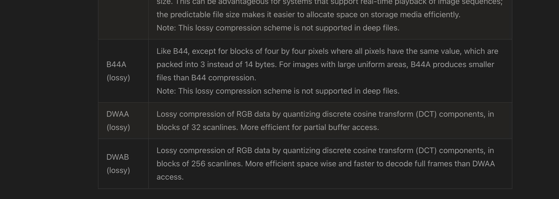

Also DWAA and DWAB are different as they’re meant for use cases.
From openexr.com and I think the “faster to decode full frames than DWAA access” is what makes it more appropriate for Flame.
This was just my conclusion but that’s really all I know and considering not too long ago one could only get fully detailed info on EXR from the ILM website…
I reality one’s probably good either way and if roundtripping with Nuke maybe even best to use DWAA?
