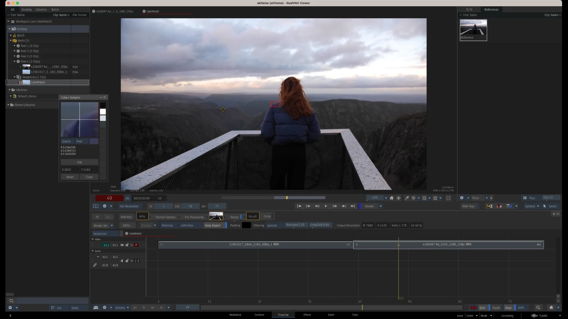

Here’s a basic technique using the AFX_ReverseGrade to match two shots:
Here is the same match using AI Color Grading - Match AI | Color.io - use your own judgement. The video above provides the necessary context.
I’m waiting to fix an install problem on re:vision rematch to compare the same with that plugin.
That vimeo link doesn’t work correctly
Sorry about that, fixed now. Didn’t test it in a separate browser, and was logged in where I tested it :frowning_face:
Here’s a comparison of all the tools.
This should be prefaced, that there are two use cases - one where two cameras shot the same scene (either separate takes in the same scene or a multi-cam capture), and one where you have separate scenes of totally independent origin, and you’re trying to harmonize the look & feel.
This test is the latter (and harder). Also the Re:Vision plugin is optimized for the former, but can create some results for the latter.
As becomes obvious - there is no right or wrong answer, and it depends on what qualities in the image are considered important, and what becomes the flex.
The key things in the reference shot in my mind is the contrast range, and the more pastel blue sky with a bit of tint to purple.
The other shot is overlay contrasty and moody, also has purple tints everywhere (sky & and the railing).
The Re:vision Rematch captured the lower contrast feel and had a balance between the purple and the bluer skies. But blew the highlights in the clouds (there are some controls)
The AFX Reverse Grade has better highlights but they sky skews too purple still.
The color.io result has a very different palette. Much more cyan. The clouds are even more cyan than the reference, and the railing too. For me it has gone too far in that direction.
Also the color.io tool I believe is a one-shot take it or leave it. Whereas the other two tools have several controls to refine the result.
(ps: original post had two shots swapped, fixed image and text above)
Maybe over the weekend I’ll try to find some shots from the same scene or multi-cam and repeat the experiment with something that should match very closely.
(updated: here’s a pass at a manual match - just with scopes and one image node)
