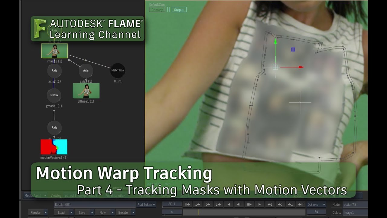

The Motion Vector map has to be parented to the gmask and you have to enable „motion warping“ in the gmask‘s (not the axis) tracking menu. Think grant also covers this in this video
Thank you! This is perfect.
Oh I see where I got tripped up. In 2021.1, I was tripped up by the schematic linking that happens by Default. When I follow @La_Flame’s instructions per his video, my schematic looks much more…ummm…complicated, including gmask links, many more parent/child connections. Watching @La_Flame’s videos, it’s clear that I need to take full advantage of the contextual menus.
