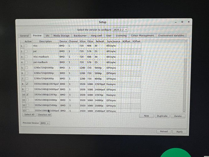

Make sure you have BMD set for all the necessary resolutions in the flame set application, Preview tab.
for sure. In fact I cross referenced those settings against the values found in /opt/Autodesk/FLAMEVERSION/cfg/init.cfg
All looks normal. It just doesn’t work.

Could you screenshot the Preferences / Project / Broadcast Monitoring window and the Preview tab in Setup application?
What do you get after a reboot?
Apologies for the iphone pics instead of screenshots… my setup is atypical today. After a reboot the issue persists.
