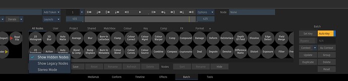

Maybe it’s hidden by accident. Try this:
oh yeah that works, it was hidden
thanks
Now you can “show” to unhide it.

Colour Correct is not hidden by default. It was only hidden for Nicolas.
The ability to hide a node from the Node Bins has been added in Flame 2025.1 Update and was featured in one of the first YouTube Shorts we published.
