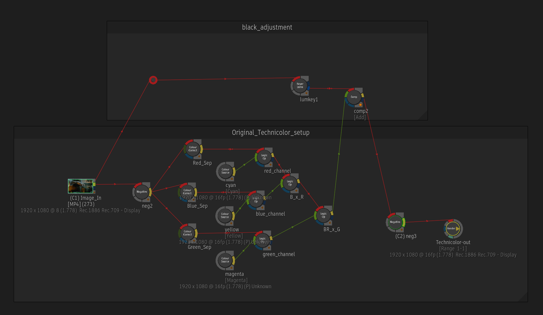

Here’s a blast from the past. I think it was shared on fxguide or flame-news. This is a batch setup to replicate the Technicolor process of the days long gone.
It basically takes the negative of the image, separates it into RGB channels (using CC node, because we didn’t have the Separate node back then), blends block colors as maximum (cyan for the red, yellow for the blue…), combines them with multiply and negates the whole thing at the end.
You adjust the block colors to affect the outcome.
You can use a luma key to adjust your blacks but I left the setup as it is from back 2001, when it was created… Rename the file back to .tar by removing .zip, forum software doesn’t allow for obsolete data formats…
Technicolor.tar.zip (30 KB)
