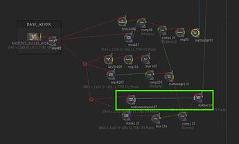

This error happened to me again, when I’m trying to create a second output matte in action. This layer has motion vector and motion blur, but how this is a simple finger roto matte, I connect direct, and the error disappears.
the layer action connects in this motion blur result.
