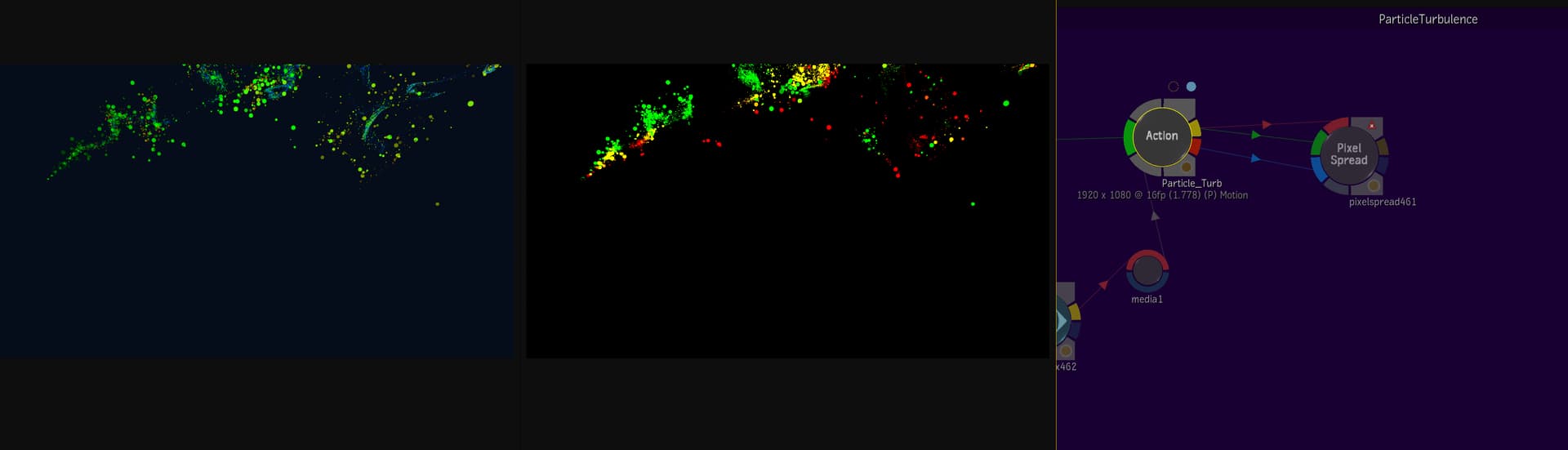

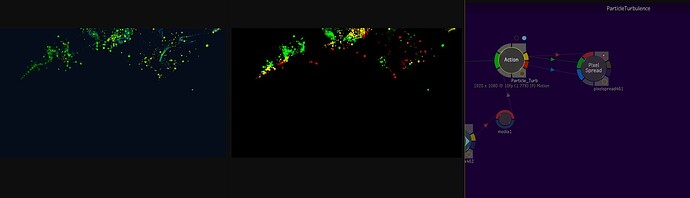

Oh Sinan, i didn’t managed to do the things you proposed with the pixel spread. When i change spread type to Vector Warp has a dead output… what am i doing wrong??
Did you enable an output pass from your action as Motion Vector and connect that to the light blue tab on the PixelSpread?
yes i did… ithought it needed 16/32 bit inputs but no
Ah, you need to connect the vector pass to the “light blue” tab on the bottom. The normal blue is for the matte.
hahaha How stupid i feel now… thanks
