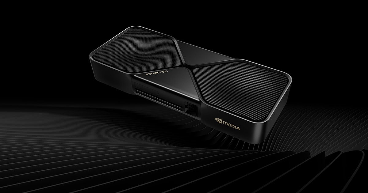

I’m doing some speed ramps on 4k material. Seems GPU is a no go. Using CPU instead. What is the gpu card you’re using to be able to render out 4K?
$8,000 will do ya.
That is the normal course of Flame…. when something is working in-efficiently, just throw more expensive hardware at it.
The P6000 is not supported in 2027 and is only minimally supported in 2026.2. Save your Christmas money.

that aint a p6000, nvidias naming is trash, its loke 4 generations newer.
I was going to say get Twixtor but the ML feature has a bug on the Linux version so it’s disabled for the time being.
Get a Mac, deliver and then return it… LOL
P6000 = Pascal = 2016
RTX 6000 = Turing = 2018
RTX A6000 = Ampere = 2020
RTX 6000 Ada = 2023
RTX 6000 Pro Blackwell = 2025
?. The P6000 pascal is EOL. Not sure what the name has to do with it.
i thought you commented on alans link maybe not :person_shrugging:
Finn and I both thought that you wrote P6000 is not supported replying to Alan, and we assumed you thought P6000 was the same as the 6000 Pro, which, makes total sense, but is of course incorrect.
