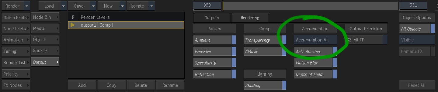

You need to set Accumulation to All on your Action output. This turns on filtering for all data passes.
Ah ha! That’s the real solution.
Thank you @chrislovesflame
