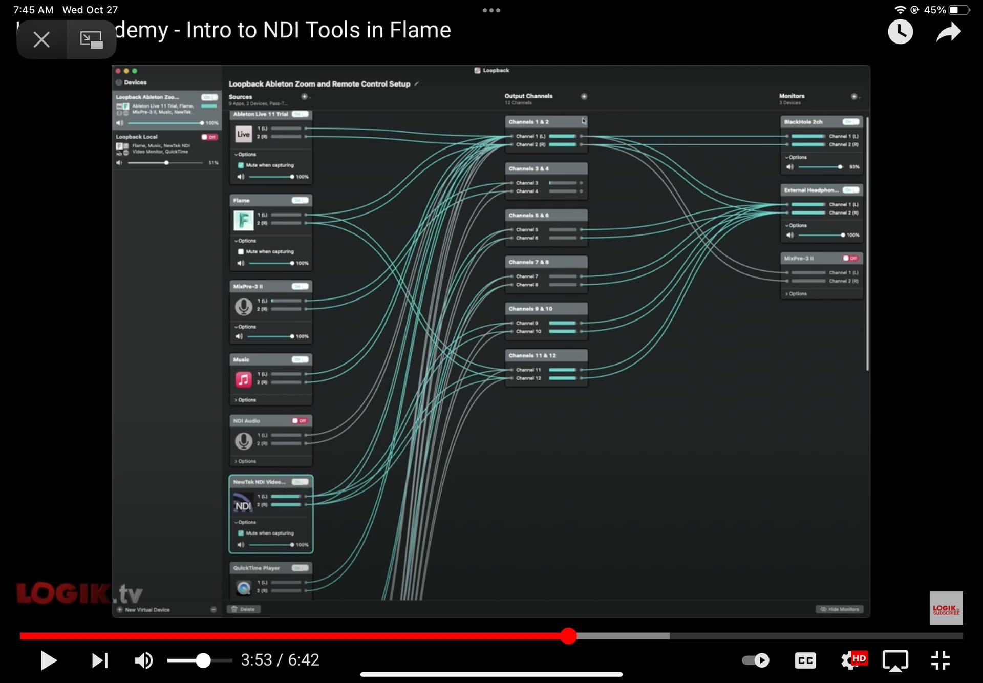

Option 2. Software. To output SDI picture/audio AND play audio out of the Mac’s onboard speakers, you’ll need to use Loopback Rogue Amoeba | Loopback: Cable-Free Audio Routing. It basically is a software router for audio on the Mac and you can setup a kinda node tree for you audio to grab audio multiple sources and feed them to multiple audio monitors/devices.

Ooh! @Sinan check out this still frame from my Intro to NDI video. This is Loopback in action. See how in Loopback Flame Application has more than 2 “audio outputs’ coming from it? Those channels aren’t REALLY channels, they are more like “Mux nodes” in that they are ways to group audio and then feed multiple audio devices.
In your configuration, the ‘Blackhole’ audio monitor will likely be replaced with your Blackmagic device.
