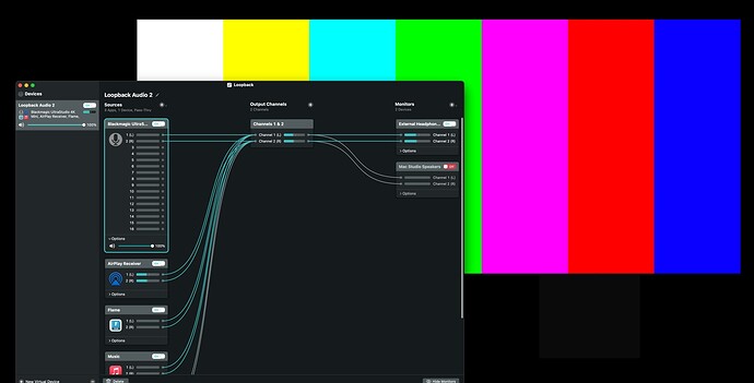

So, what you would do is set your BMD as both video and audio.
In loopback, you should see your BMD device as a Source. You’d add your BMD as an Audio Device specifically, I believe. You can then route it to your MacOS audio (headphones), wherever you want, etc…
It looks something like this:

When you have Flame set up with BMD for both Audio and Video in your config, audio turned on, and can confirm life in the audio bars in flame… (bars + tone for example), you should see life in the bars in loopback…
One thing to also troubleshoot, is loopback monitoring your inputs on the ultrastudio vs. the outputs? I’d noodle with spinning down the options arrow and seeing if you have anything to tick in that zone.
My mixer, for example can route my computer’s output to a pair of input channels that can be seen by loopback if needed. You might see if the BMD device can “bounce” the flame’s stereo output to any pair of input channels… You can also do this the analog way by literally connecting your output channel pair physically to your input channel pair.
Another thing to check out, would be to uncheck “mute when capturing” under Flame’s dialog box and see if that allows audio to pass through (even though BMD is set as the audio output)
so ive got audio on the flame - audio meters show it. mute when capturing is off. it works for airplay and iTunes and anything - I can hear it and see the audio meters in loop back. but nothing on the flame one and nothing on the black magic one. I thinks its because the black magic is a source for its inputs- like its a 16 track audio box. im not sure its actually the outputs. anyhow it works for everything apart from flame at the moment
So I think the next step would be to see if the blackmagic config app or audio/midi settings in macOS will let you “connect” your BMD Outputs 1/2 to BMD Inputs 1/2 virtually.
If no options for that exists, you can literally connect a pair of xlr cables or 1/4” TRS cables (not familiar with the physical I/O of your BMD) and physically “loop back” the output of your BMD to the input of your BMD. Then you should see life in the BMD meters in the loopback app and route accordingly.
You’ll also likely need to offset the broadcast picture delay in flame to compensate for the slight audio lag of the workaround, but it should work.
Hope that helps!
