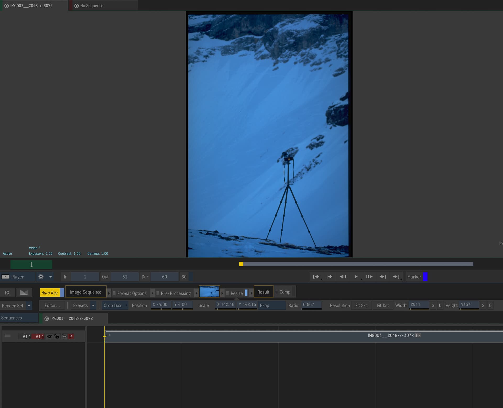

It certainly can.
  1. Enter the Timeline FX Resize editor
  2. Display the Front view (F1) in a viewport
    → You should see a green Crop box in the viewport
  3. Move the Crop Box so it surrounds only the image, not the the black border.

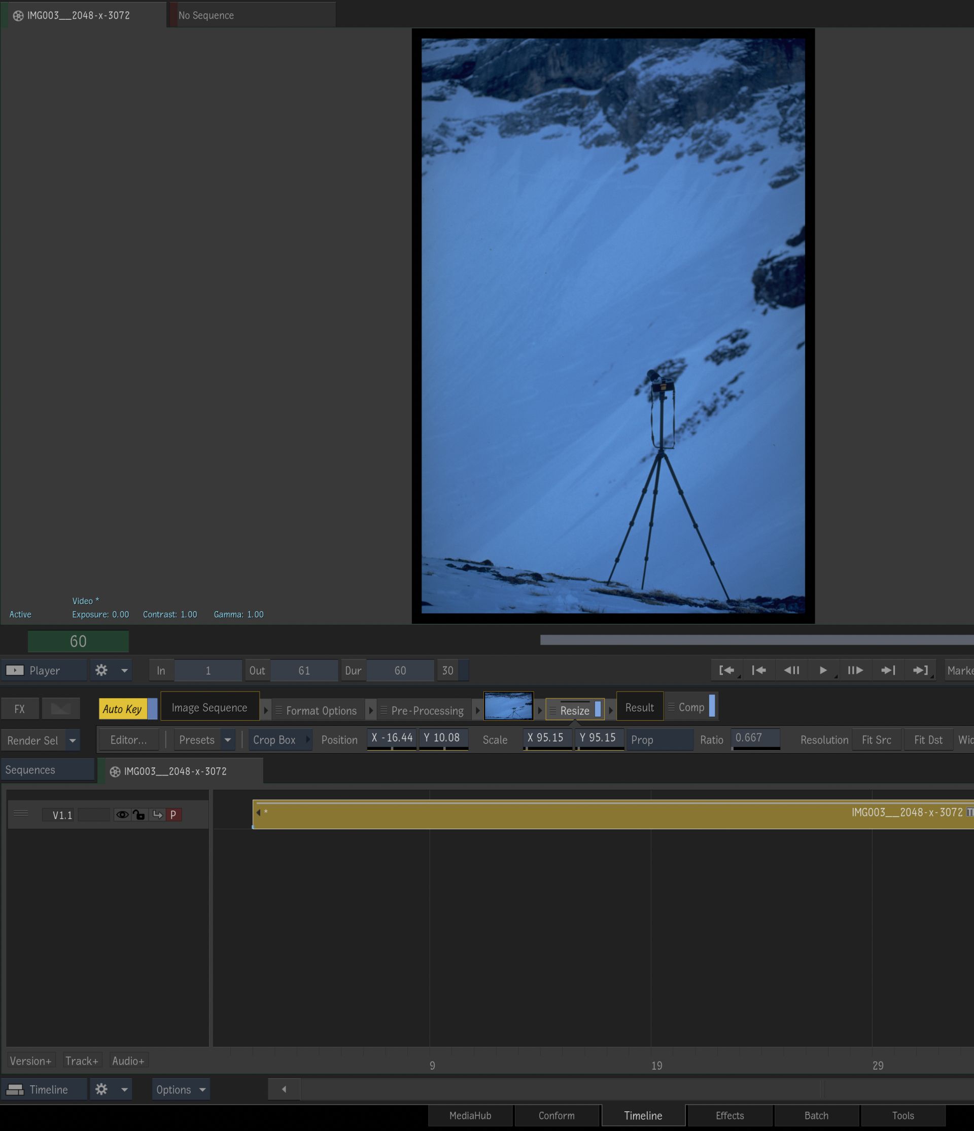

Thanks for your help! The cropping seems to work, but the black borders are even larger than before in the sequence (Timeline) .
What I am doing wrong?
It looks like you are doing a resize as a soft effect on a clip therefore you cannot change the resolution of the clip through cropping. Try using the resize module from the Tools menu directly.
From there you can enable the “crop/lock output” option. This will trim the clip to the size of the green crop box you are using to get rid of the black borders.
Thank you for your help. It does work - at least nearly:
The final output seems to miss some frames …
Pls have a look at: SwissTransfer.com - Envoi sécurisé et gratuit de gros fichiers
Any additional help is appreciated. Thank’s a lot!
Hi there Joe,
A couple of things to note.
  1. you have a soft resize applied to your 60 frame clip as well as resizing it on the desktop. You are doubling up on the resizing which is unnecessary. Delete the timeline resize by alt + clicking the blue dot on the timeline resize.
  2. when you render out the desktop resize you are parked on the last frame. That is why your rendered result is only one frame long (not 60). Scrub the timeline back to frame 1 before you press render in the desktop resize module.
