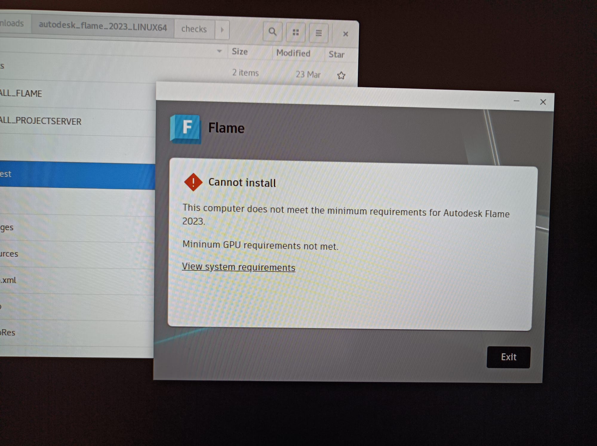

GPU requirements not met
Hi all,
Was trying to setup a low-end Flame station for basic assist work - project setup etc.
The system only has a Nvidia GTX 1650.
Is there a way to bypass this error upon install?
Thanks in advance
Haven’t had to do this myself but setting up DL_NO_CHECK as an environment variable and giving it a value of 1 should bypass GPU requirement check for headless systems.
You can do this in the terminal by entering DL_NO_CHECK=1.
You can check you have set the environment variable by running…
echo $DL_NO_CHECK
it should return 1
Then install flame using the same terminal window by running
./INSTALL_FLAME --noui
Note: I don’t know if you will be able to run Flame, but this should allow you to at least install it.

Hi,
Thanks for responding.
As I mentioned this system is only to assist a larger, more powerful system so really won’t even make full use of the GTX 1650 that’s already installed.
I will try [friendlyape]'s suggestion when I get the chance.
