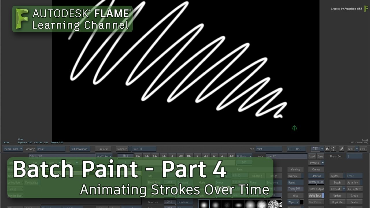

Hi All,
I have no intention of interfering with your poll but I have seen a few comments on how to recreate the “auto-paint” function using batch paint instead of desktop paint. I have seen a few recommendations of painting one frame at a time (slight shiver :stuck_out_tongue: ).
However did you know that Batch Paint already has an “auto-paint” or “write-on” function?
I made a video about it a long time ago and I thought it might be useful to those who need it.
Thanks
Grant

If somebody wants to submit a request at Flame Feedback to have these controls in the UI and not only in the Animation menu…
done:
https://feedback.autodesk.com/project/feedback/view.html?cap=5afe6c845cb3447ab36ccbd7f0688f84&uf=e219e6fecf5541119b3d9eabb6b8f1bb&new=1&ifps=-898&f={8fbadb72-c1b4-44ad-b55e-888e3fdc17e4}&t=0&fti=2
Ehhhh . . . . not quite the same. It will certainly produce a mechanical version of what we were discussing, but it lacks finesse. For instance if I am erasing characters one frame at a time, then reverse and stretch it out over time (using my very old method) the characters will pop on one at a time. WIth the automated method, it will show the brush strokes as it paints the character on. Also, with the classic method, one can finesse each character properly so that when working backwards, for instance, I can remove the cross of a lower case “t” without making a space in the upright. If I were simply doing it with an automated brush stroke, that would not be possible without adding extra strokes that will upset the smooth timing, or I would need to make separate start/end frames for individual strokes, thereby defeating the purpose of the automation. Don’t be afraid of frame by frame, Grant. Be one with the pixels.
