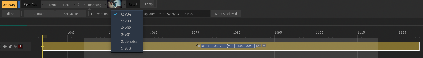

If you’re working unmanaged, I’m a big fan of using the versioning system’s number and name to bake those mattes or precomps or uvs or depth maps into a single open clip stream.

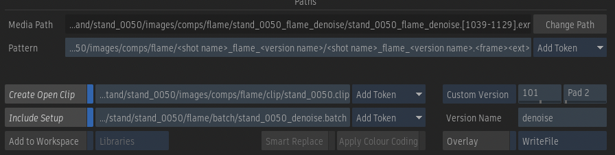

So in the above which is an example of denoise, I start with a my write-node fresh from the publish. I copy it and set the versioning logic to custom version. I set the version number to 100 for denoising pre-renders and then I change the version name to denoise.
When I render this I will have injected my denoise render into my open clip versioning such that it appears in the ribbon like so:

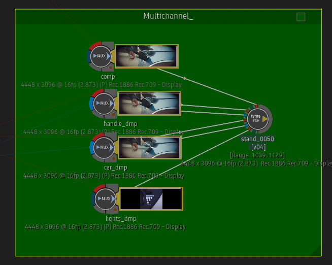

There’s another method as well if you want to keep those extra elements even more tightly interwoven. Change your main write-node from rgb-a to multichannel under format:
…and then increase the number of channels that you wish to store in the file. In this case I picked 4 channels to store various aspects of my comp. The comp, the handle paint work, the car-paint work and a random charger detail frame.
Next connect up all of those inputs into your write node. I’m not allergic to hiding mux connections so mine looks like this:
Back in the write node, name those extra channels something you can remember. You don’t need to get creative. To be honest you don’t have to do anything at all if you don’t want to–there are always default names assigned regardless of what you do:
…and then render. What’s nice about this is that it doesn’t destroy your openclip structure. Any open clips referencing that stream are none the wiser that you just packed the EXR it’s referencing with more channels that just rgba.
If you use the script for importing write node’s openclips as I did above, you’ll get the same rgba single channel set node like we got from the denoise. Under the hood they’re still all there but the original openclip definition for the source references only a single channel set so that’s a limitation.
But those channels ARE still there and when you need access to them, you just right click on the multichannel write-node and use the Logic portal script Reveal Write File Path in Media Hub/Finder and import the sequence back in–not as an openclip but as the actual exr multichannel sequence it is.
…at which point you have access to all of those channels back in batch, cached into an exr on disk and ready to go.
It sounds like it’s a pain, but it’s actually only a couple clicks–many of which revolve around connecting what you actually want to pre-render to the node. Once the initial setup is done it versions like every other write node and you’re always rendering the most current version of those elements (if you want to).
