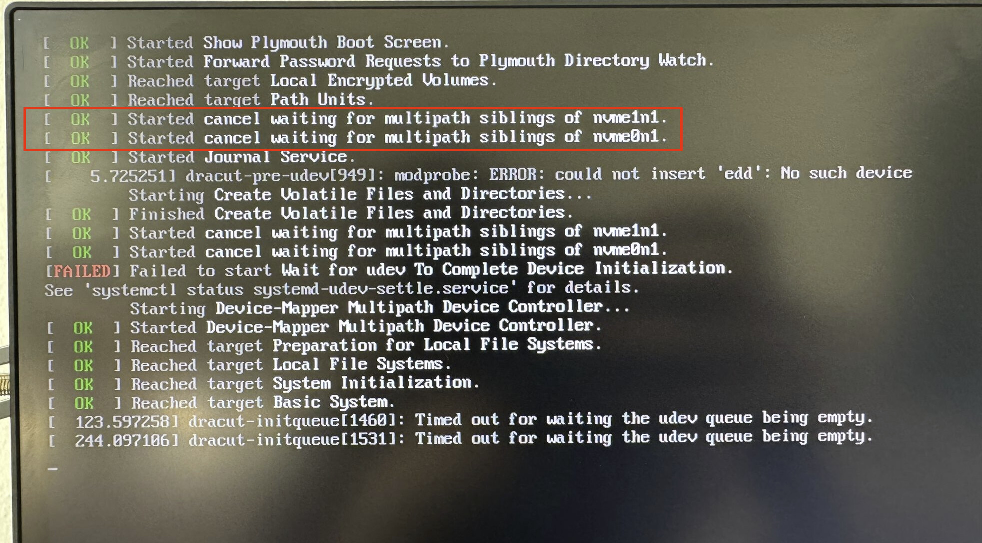

Hello,

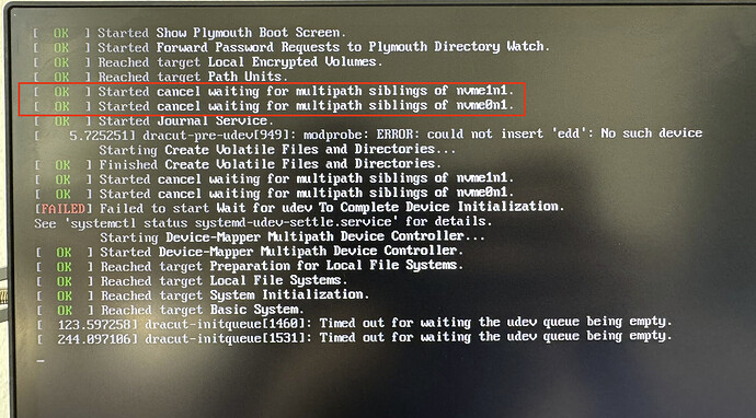

I’m trying to install Rocky Linux on my computer for my home setup, but during the initial boot phase, after selecting “Install Rocky Linux (manual partitioning)”, it stays at the point I marked in red for about 30 minutes. Then I get the error shown below, and the screen goes black with only a blinking underscore in the top-left corner.
I first tried version 9.5, then 9.3. My device has two NVMe SSDs, and I removed one of them and tried again. In the BIOS, Secure Boot is disabled and the boot mode is set to UEFI. However, I can’t get past this screen.
If you have any knowledge about this issue, I would appreciate your help.
If someone else experiences the same problem, disabling the onboard GPU in the BIOS fixed the issue.
