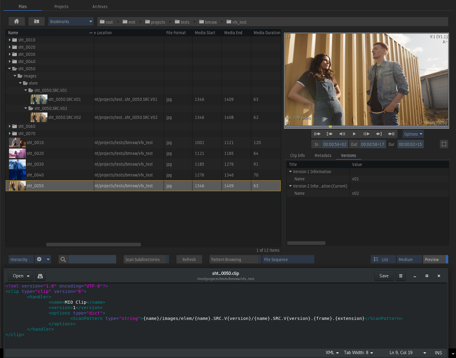

OK had to try this for my own sanity:
Image sequences where generated outside Flame, but I guess that doesn’t matter.
Open clips at the bottom referencing sequences inside the folder structure.
The openclip internals are all the same. Only thing that changes is the filename itself which in this case is the shotname. Since is pattern based, it will account for upcoming versions.
<?xml version="1.0" encoding="UTF-8"?>
<clip type="clip" version="6">
	<handler>
		<name>MIO Clip</name>
		<version>1</version>
		<options type="dict">
			<ScanPattern type="string">{name}/images/elem/{name}.SRC.V{version}/{name}.SRC.V{version}.{frame}.{extension}</ScanPattern>
		</options>
	</handler>
</clip>
I still don’t know if this answers the main question, but it was a good exercise. :rofl:
