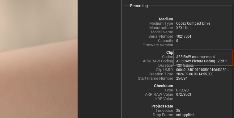

Not sure what Finn has come up with, but the best I can do is load it into ART (Arri Reference Tool) and re-export as OpenEXR Uncompressed Scene Linear/AWG, then load that into flame as ARRI wide Gamut 4. Although it seems to have misinterpreted the aspect ratio. I believe ART can do this in bulk to multiple shots.
I’ve also looked at Alexa35 footage with older and newer Software updates and one clip that is HDE codec and Software version 1.3.0, which is the same as the problem shots, and all load fine. Out of the 4 shots, the problem shot is the only one with Enhanced Sensitivity Active. I have no idea if this has anything to do with the problem.
Hi,
It seems the ARRIRAW Picture Coding line is quite suspicious. Typical files are either 12-bit or 16-bit, but yours shows 13-bit. It appears that Flame may not recognize 13-bit camera files directly. You should consider converting the file using the ARRIRAW Tool or Resolve.
All of my shots that are Alexa35 Arriraw are 13bit and load fine. I think there is some sort of corruption in the metadata. Conversion in ART to Arri Log4 seems to be the solution. The only thing I found unique to the problem shot compared to the 3 I have that load is the Enhanced Sensitivity is active. I have some time to kill today, so I might take a look at some of the samples Arri provides and compare.
EDIT: I found a sample with Enhanced Sensor active and it loads fine. So much for that idea.
