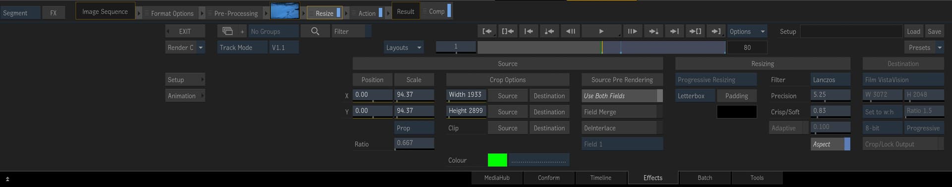

Sorry that I need to ask such simple things… but was unable to determine the aspect-ratio of the landscape shots:( I am I looking at the wrong place?
Thank’s Ryland for that important information ![]()

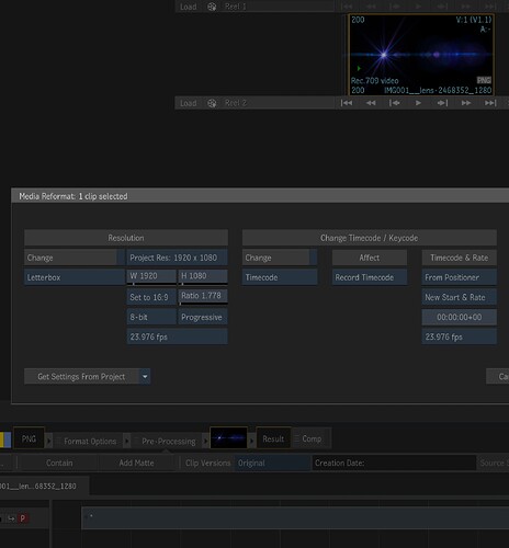

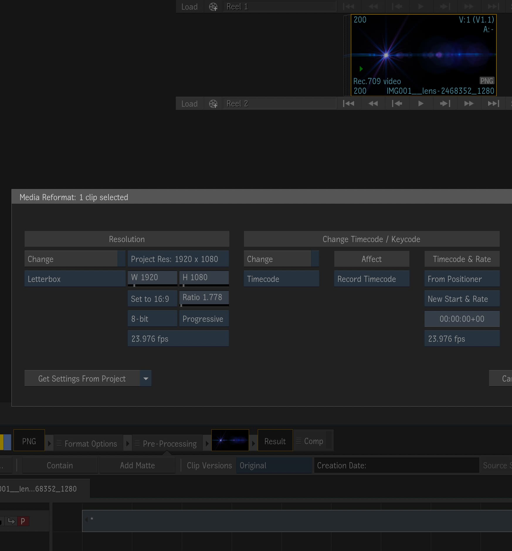

You’re looking in the Effects Tab. You need to be looking in the Timeline tab. At the bottom of the interface, select Timeline. Then in your Desktop or Libraries, double-click the clip you want to determine the resolution of. This clip or timeline should appear in the viewer. In the bottom right corner of the viewer the resolution, aspect ratio, and colorspace of the clip will be displayed. Also as KuleshoEffect mentioned, you can also hold-alt-click on any thumbnail on your Desktop or in your Libraries to see this information.
