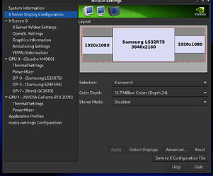

My nvidia settings looks like this :

I’m not sure how good Flame is with multiple displays that have different resolutions.
The other thing I’ve found over time, is that if you switch displays, the order matters. If I switch the left display that has the UI last out/first in, then the order remains in tact. And you have to give it a beat so it can detect and do its thing. Not sure if that’s a matter in your case.
I had this issue a couple of years ago, using 2 different res monitors on linux, it totally screwed up my display, even when I switched back to one monitor.
I have two monitors, main for GUI (2560x1440) and secondary for client monitor (1920x1200) using hdmi output option with no issues with single screen UI option disabled in utilty config tool.
I did try to enable and disable that option, but I get the issue with the two monitor UI being offset too
I recall Alan’s trick of splitting one ultrawide monitor 80/20, and that seems to work Ok.
-Ted
Issue fixed!
My font scaling factor in system “tweaks” was 1.3, I guess it was messing with Flame positioning itself on the screens.
Set it back to 1 and it works fine.
