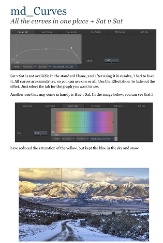

MD_curves
Peter. This is exactly why I posted here. Thank you, thank you, thank you for this! I can’t wait to test it out for real!!! I scrolled through so many Matchbox shaders, and for some reason I missed this one.
And sidenote- where is that wonderful description? I assume this is some website that have descriptions for all of the md_ shaders?

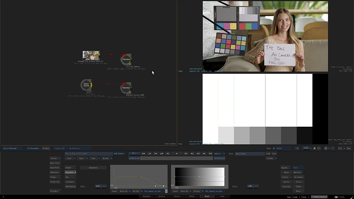

I just noticed, there is also Ivar’s crok_sat_vs_sat
