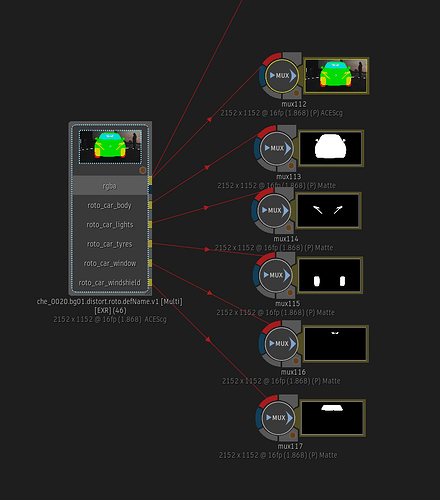

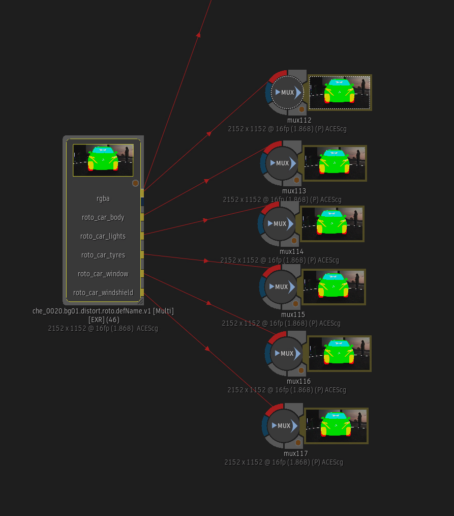

To add … when sequence publishing Multi Channel EXRs, Flame puts the main RGB channel in all additional channels and does not actually export each assigned channel.
When “Include Alpha” option is selected it only exports Alpha for the first RGB-A channel.
Hoping this is just user error.
This is OG file …
This is published sequence file …
